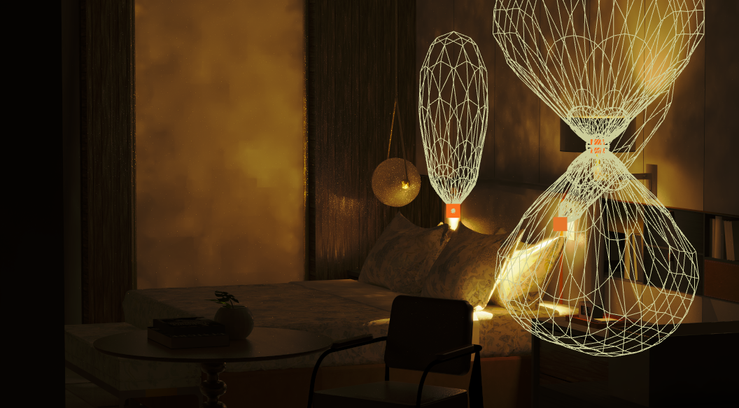

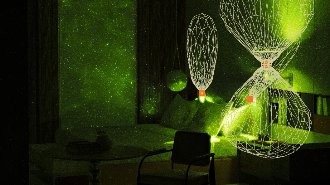

I am experiencing an issue with the light colour change when I switch on the GPU mode. I created a KeyShot file on my iMac, packaged it, and opened it on a Windows laptop. For your reference, I have attached the pictures below. I hope you can assist me in resolving this matter.

CPU Mode
GPU Mode

I looked at your scene but there is really a huge difference in color, same if it’s just on Windows between CPU/GPU mode. I wonder what is actually causing it. Maybe Will has an idea since he also switches more between CPU/GPU I think.

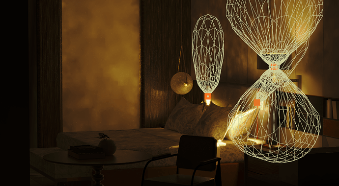

Hey! I found the issue. You’ve got a curve fade node plugged into the multiplier value of each of the IES lights. For some reason, that’s causing a hue shift. If you remove those nodes, they seem to work correctly in GPU mode.
